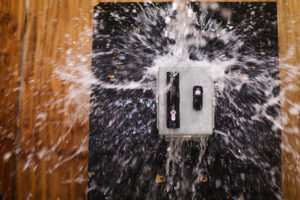

When choosing the appropriate compression latch, consider environmental requirements, such as whether the application will need to be sealed against moisture, rain or water spray.

The physical environment may also present other challenges for a latch. Exterior applications may need to withstand sun and wind exposure, or chemical exposure due to weather or cleaning solvents. Such factors can determine the appropriate material choice to hold up to the elements over time. External factors can also include sealing against moisture, rain, or water spray, which can lead to different latch sealing choices to protect the enclosure interior.

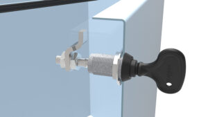

The smooth operation of Southco’s E3 VISE
ACTION Compression Latch series aligns the
cam behind the frame and draws it up tight,
with a single continuous half-turn motion,
providing extra leverage over gasketing and
different panel thicknesses.
Many customers require compliance with industry-specific standards, such as fire, vibration, and sealing (such as the IP65 rating for dust and water resistance or the NEMA 4 rating for ingress of water), which require latch suppliers to perform testing to validate performance.
