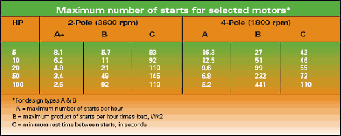

Intermittent duty is more complicated. The life of commercial airplanes is measured by their number of landings; in the same way, the life of a motor is proportional to the number of starts it makes. Frequent starts shorten life because inrush current at startup heats the conductor rapidly. Because of this heat, motors have a limited number of starts and stops that they can make in an hour. NEMA standards for a range of motors is shown in the table.
Selecting a motor for intermittent duty begins with an educated choice. A rule of thumb is that for every 10° C cooler that a motor operates, it’s life doubles. Therefore, for maximum life, a motor must run at less than maximum temperature. If a motor is sized for peak load alone with no consideration for the number of starts it must make, it may burn out rapidly in intermittent duty. However, by choosing the next size larger motor, you gain greater capacity for coping with frequent starts.
