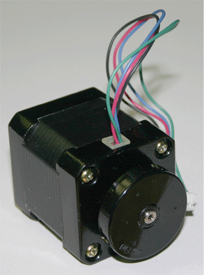

3. Smooth motion
Step motors have an advantage over many others because they can stop at any location that a program commands. However, as the name indicates, these motors move in distinct steps. In order to move one revolution, a 1.8° motor must advance 200 steps.  Each step the motor takes requires a few microseconds to settle and it creates a slight oscillation before completely stopping.  If these oscillations continue to add up with each step the motor takes, the motion can be jittery — not very smooth.
In choosing a step motor, it is often difficult to determine whether the motor will operate smoothly in the application. However, there are ways to create an environment for the motor such that smooth motion is possible. In most cases, motors are too powerful and produce jittery motion. Also, select a motor that has the proper amount of torque. Talk to an applications engineer to help eliminate any guesswork while choosing the motor. If the chosen motor turns out to be too powerful, decrease the voltage or current to decrease torque. In addition, mechanical dampers can be placed on the end shaft of a step motor to increase its weight and dampen the jittery motion.
This NEMA 17 step motor illustrates the use of a mechanical damper mounted on the end of the shaft to help reduce the step vibrations and resulting noise.

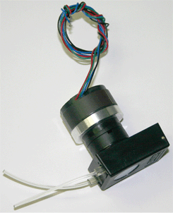

Medical applications particularly require high reliability in most situations. Therefore, selecting the properly sized motor is not the only factor. Selecting the most reliable motor manufacturer is just as critical. Many customers request MTBF (Mean Time Between Failure) specifications  to ensure that their potential motor will last a certain number of cycles. Although these requests are reasonable, step motors are extremely robust when used correctly. Generally, when a step motor is used under the correct load conditions (both axial and radial loads of the shaft), and when environmental conditions are within specifications, step motors have a long life. The life of a step motor usually correlates with the life of the bearings within the motors, which can last as long as 20 years. So, whether the application involves making intricate cuts within a human’s eyes, pumping fluids, or any other type of medical application, a motor’s size, accuracy, smoothness of motion, noise level, quality, and reliability are all extremely critical factors.
Miniature step motors are ideal for driving medical pumps that must deliver small, accurate quantities of a liquid.
