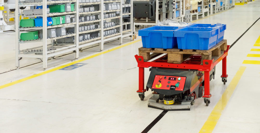

This also goes for automated guided vehicles (AGVs). For example, the most appropriate position to completely cover an AGV is to have two scanners adjacent to each other on the corners integrated into the vehicle (See Figure 1).
