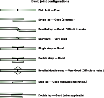

Step 3. Joint design
Joint design is another important factor in determining how well an assembly will survive service loads. Adhesives should be part of the initial design of a component – not an after-thought. Bond failures are most likely to occur when adhesives are simply substituted into existing assemblies that were designed for use with traditional fixing methods.
Proper joint design requires that loading stresses be directed along the lines of the adhesive’s greatest strengths. Adhesives are strongest in shear and tension and weakest under peel and cleavage loading. An adhesive’s strength is usually strongest when stressed in shear because the entire surfaces of both substrates are making contact. Bond-line thickness only moderately affects bond strength. Uniform joint thickness and a void-free adhesive layer are more important considerations.
When specifying a joint design, Brenner notes that the bigger the area, the better the adhesion. “I see many people who try to use butt joints, sometimes referred to as point-to-point. The only way to use this type of joint is to put a third part on top of the butt joint or to use a scarf butt, where the two substrates are angled and mated.” Otherwise, some type of overlap is necessary for a joint to hold a bond.
Joint stress affects joint design
Adhesive joints are subject to four specific types of stress, including tensile, shear, cleavage, and peel. Tensile stress happens when forces acting on either side of the material pull them apart or elongate them. Shear stress occurs when forces acting parallel to the joint are distributed across the entire bonded area. The two materials then slide across each other. Cleavage stress occurs when forces at one end of a bonded assembly pull the substrates away from each other. Peel stress is similar to cleavage stress, but it applies to a joint with flexible substrates.

Cap joints are probablly the most commonly used types of joints. Here are some examples.
