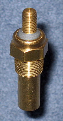

Unleaded NTC thermistor discs are frequently used in numerous automobile engine sensors to measure air and coolant temperature. The discs are located inside the tip of the housing, usually under a spring-load to maintain contact pressure.

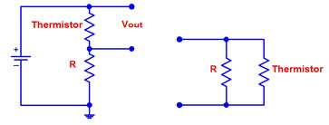

By simply adding one resistor in series with the thermistor, the output voltage vs. temperature curve can be linearized. When resistance vs. temperature linearization is desired, the resistor should be connected in parallel with the thermistor.
Circuits for linearizing thermistor outputs can be comprised of series, parallel, and series-parallel combinations of fixed resistors and additional thermistors. The simplest circuit is a parallel resistor, the value of which can be calculated from the following equation:
R = [RTM(RTL + RTH) – 2RTLRTH] / [RTL + RTH – 2RTM]
Where:
R = value of parallel resistor, Ω
RTL = thermistor resistance at the lowest temperature TL, ?
RTH = thermistor resistance at the highest temperature TH, Ω
RTM = thermistor resistance at the midpoint temperature TM, Ω
Midpoint temperature TM = (TL + TH) / 2, °C
