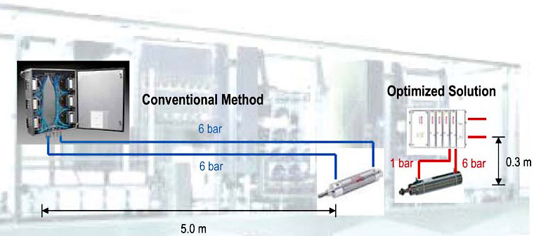

2: Reduce volume by cutting distance between valves and actuators
You can substantially increase machine efficiency by reducing lengths of tubing runs between components. Thus dead volumes are reduced and pressure losses are avoided through shorter tube lengths.
Look closely at the advantages of decentralized air supply. Centralized valve manifolds are typically cumbersome, require long air lines, and consume a lot of energy. Vendors now offer small, decentralized valves and manifolds that concentrate pneumatic functions at the point of use. Valves can mount directly to cylinders without hose connections. This direct connection eliminates pressure losses through long lines from the control cabinet to the pneumatic drive. Valve/actuator units can reduce tubing connections by 50% and cut energy use by 35%. Decentralized systems can also yield faster response times and higher cycle frequencies.

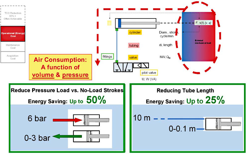

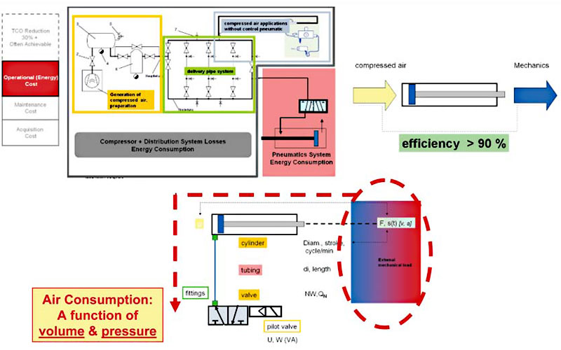

Four most common areas where energy is consumed in pneumatics systems.
To reduce pneumatics system volume, reduce distance between valves and actuators.

Air consumption is a function of volume & pressure. Control them both and you have managed energy consumption.
3: Avoid using excess pressure
Pneumatic systems frequently waste energy by supplying higher pressure than an actuator needs. For instance, in many applications cylinders either push or pull a load, but not both. Yet most often machines use the same pressure for both extend and retract strokes, which is extremely inefficient.
Using pressure regulators to supply the right pressure for each task can lower energy consumption by more than 25%. For instance, “smart” regulators combine digital control electronics with proportional valves. They constantly compare preset pressure limits with actual values to ensure exact metering.
Rexroth’s term for this is energy on demand, based on decentralized intelligence to adapt the pressure individually to needs and thus raising energy efficiency. The pressure profile of an actuator’s movement is divided into different phases: Start, movement, end and return stroke. Start and end phases usually require high energy, while movement and return stroke phases can be performed with a significantly lower pressure. Even if the reduced pressure usage distance appears short, it is sufficient enough to optimize the motion and to minimize hard end position stops. When many thousand repetitions of the movement are performed, the incremental savings accumulate to a noticeable efficiency increase of the entire process.
One concern to guard against: operators commonly increase supply pressure on regulators in hopes of improving performance, but this wastes significant amounts of money in air and operating costs for no actual benefit – if components are sized correctly. It is important to monitor and ensure machine pressure remains within designated limits to avoid wasting energy.
