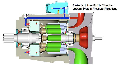

Pulsation reduction with a pre-compression chamber

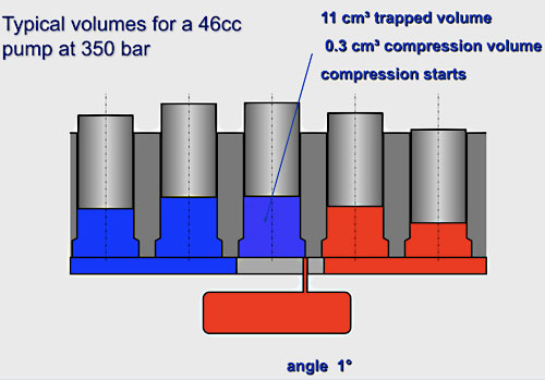

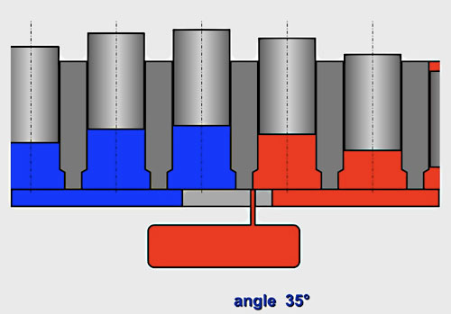

One new pump design uses a pre-compression (ripple) chamber design in the pump to reduce the output flow pulsation. In the first part of the compression phase, an internal chamber – filled with fluid under pump output pressure – is connected to the piston coming from the low-pressure side. Fluid now starts to flow back into the chamber to refill it.
Chamber refill ends with refill time covering 25° of rotation. As the volume to bring the piston chamber to 350 bar is reduced by the ripple chamber input, now a lower average flow is required from the pressure chamber to have it refilled when the next piston gets connected. As a result, the peaks in the flow are reduced by more than 50%. The whole system is less excited by the reduced flow pulsation and is quieter. Built to a power unit and incorporated into a hydraulic system, the lower pulsation causes a total reduction in primary and secondary noise by 3 dB(A) typical, and in some cases even up to 5 dB(A).
