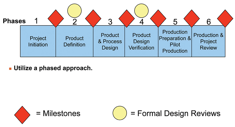

—Develop a robust product development process marked by milestones and formal design reviews.

Robust design process
Such decisions are often critical to product performance. For this reason, gate mechanisms are often used to provide technical and general management with oversight and control over go or no-go decisions. Schedule design reviews at defined points in the process where the product or process design is assessed before the project continues. The review team should consist of members who are knowledgeable about the technology involved but not directly involved in the project in order to provide objective viewpoints. Reviews should not be limited to simply the design of the product but should also address product lifecycle requirements such as product portfolio consolidation or extensions, as well as program requirements such as cost, schedule, and risk.

“Gate mechanisms” can help technical and general management with oversight and control over go or no-go decisions. Design reviews at defined points in the process, for example, assess the product or process design before a project continues. Reviews should not be limited to the design of the product; they should also address product lifecycle requirements such as product portfolio consolidation or extensions, as well as program requirements such as cost, schedule, and risk.
