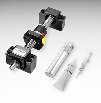

There are several methods of delivering lubricant to a ball screw assembly and several methods to retain the lubricant in the lubricated assembly. For example, a grease lubricated ball nut may have a grease fitting on the nut flange (if there is a flange) or on the nut body. The installation of wipers or seals will contain internal lubrication and repel external contamination. Oil systems require a pump, filtering system, and application method.

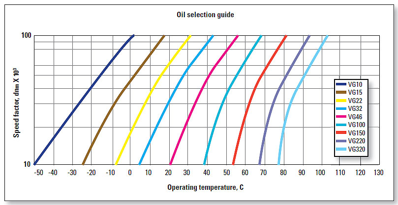

Operating temperature, load, and speed determine the oil viscosity and application rate needed for each installation. Oil that is too viscous or applied too heavily can allow heat to build in the ball screw assembly. If the oil viscosity is too low or you use too little, parts may not be coated adequately; friction and wear may result. The selection of the oil lubrication will directly influence the temperature rise of the ball screw and the life of the assembly.
The following guidelines are appropriate for most applications, but if extremes in temperature, load, or speed are involved, you should consult with a lubrication specialist. Metric measurements are represented in these guidelines. If inch size ball screws are used, convert the measurements to metric dimensions.
The recommended nominal viscosity of the oil at 40°C is based on the mean speed of the ball screw, its diameter, and the temperature at which the ball nut is likely to stabilize. Viscosity is expressed in centistokes. (1 cSt = 1 mm2/sec) Various grades have been selected for standardization and are used in the oil selection guide shown in figure 1. For example, VG32 is oil with nominal viscosity of 32 cSt at 40°C.
To determine the nominal viscosity of the oil for an application, you need to establish the mean speed of rotation of the ball screw and, from it, the dnm factor. You also need the temperature at which the ball nut is likely to stabilize.
Mean speed of rotation accounts for the ball screw’s duty cycle:
Where:
nm = mean speed, rpm
n1,2,3… = speed for time q1,2,3…, rpm
q1,2,3… = time at speed n1,2,3…, % of total
For typical applications, nm ranges from 200 to 500 rpm.
The dnm factor is given by:
Where:
d = ball screw nominal diameter, mm
Typical values of dnm are in the range of 5,000 to 25,000. Values of dn up to 160,000, where n is the maximum speed of rotation, are becoming more common, and in such cases, the lower viscosity should be used if the oil selection guide indicates a grade midway between two adjacent viscosity curves, such as VG32 and VG46.
Ball nut operating temperature should be approximately 20°C, but this is seldom the case in real operation. Usually, a ball nut stabilizes a few degrees above screw shaft operating temperature. If you can’t measure nut temperature, assume it to be 30°C for your initial selection of oil viscosity.

Grease lubrication
Greases can be applied directly to the screw threads near the root of the ball track or pumped directly into the ball nut if lube holes are available. It is recommended that wipers be used to contain the lubricant within the body of the ball nut.
