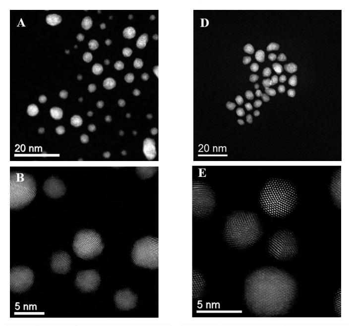

Representative HAADF images and particle size distributions for the unsupported AuPd-PVP sol in the fresh (A to C) and after a CH4 oxidation reaction (D to F). (Credit: Graham J. Hutchings and Christopher J. Kiely)

According to Kiely, the researchers were surprised to find that for this particular reaction to proceed they needed the Au-Pd nanoparticles to exist as free-floating colloids in a very weak hydrogen peroxide solution into which they injected pressurized methane and oxygen gas.
“Usually when we use Au-Pd nanoparticles as catalysts they are nearly always dispersed on high surface area oxide supports such as titania,” said Kiely. “In this case however, the presence of the ceramic support turned out to be highly detrimental.”
