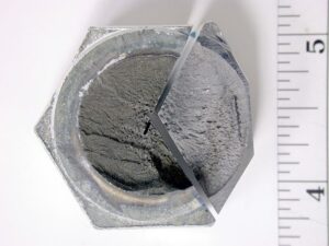

The head of a 5/8″ diameter, zinc-plated socket cap screw bursts off a piece of recently produced equipment and shoots, much like a bullet, across a manufacturing plant, through a metal toolbox — just missing a nearby worker. A 5/16″ wave washer fractures, causing a product recall of $400,000. A hardened wood screw breaks, causing a chair to collapse and resulting in the loss of life.
This is what hydrogen embrittlement looks like on a bolt.

Consider which is stronger, a candy cane or a piece of soft chewy taffy? Certainly, a candy cane is hard and has high tensile strength, but it’s also brittle. Taffy is soft, easily stretches in tensile pull, and is ductile. Now, think about creating pressure within the structure of a candy cane. What would happen? It would likely explode or burst, which is how a hydrogen embrittlement fracture is described — as a burst.

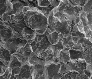

What’s more: the surface of a hydrogen embrittlement rupture looks similar to rock candy. So, the hardness of a candy cane is highly susceptible to failure because of HE cracking.

A close-up of hydrogen embrittlement at work.
