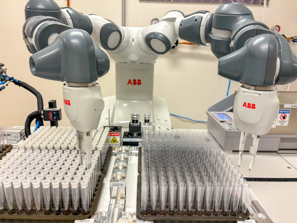

ABB robot in Texas Children's hospital

ABB Robotics engineers collaborated with researchers at Duncan NRI to design and build a fly transfer workstation, which includes the YuMi cobot, a table stacked with vials for transfer, a barcode and labeling unit, and a trash chute.
“This innovative solution to accelerate biomedical research is a result of our close partnership of more than two years with ABB Robotics,” said Dr. Juan Botas, professor in the Department of Molecular and Human Genetics and the Department of Molecular and Cell Biology at Baylor College of Medicine and principal investigator at Duncan NRI. “Combining the fruit fly biology and high-throughput expertise of DNRI researchers led by me and Dr. Ismael-Al Ramahi, an assistant professor at Baylor College of Medicine and also a Duncan NRI investigator, with the automation expertise of ABB engineers, allowed us to design a cobot-based solution, which reduces time, eliminates strain loss, and allows for more experiments to be conducted in parallel.”
The YuMi handles the entire process of flipping fruit flies, which includes performing 10 pre-programmed steps in quick succession. Just like humans, the YuMi picks up a vial containing live flies, opens the protective cellulose acetate plug, places the vial over one with fresh food, taps the vials to transfer the flies, caps, labels, scans it; and finally stacks the vial in cardboard racks. The robot then discards the vials with the old food to avoid any cross-contamination.
A significant technical feature integrated into the solution is the capability to read barcodes and print labels, which are applied to the vials with strain and genotype information during the transfer. This feature ensures meticulous tracking and management of the Drosophila strains. The robot’s advanced sensing technologies enable precise placement of vials within standard cardboard racks, granting researchers the option of continuing to use existing vial racks, reducing operational costs.
More importantly, this robot is engineered to be cooperative and safe for human interaction. Its motion-sensing arms are equipped to detect nearby humans or objects, halting movement instantly to prevent accidents, thereby allowing for a safe collaborative workspace.
