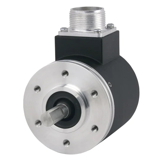

The Model 725 2.5-in. Accu-Coder from Encoder Products is an optical shaft encoder specifically designed for the challenges of an industrial environment offering resolutions up to 30,000 cycles per revolution. The Model 725 offers both flange and servo mounting options, and is available in two housing styles.

For industrial applications that require absolute positioning output, the Encoder Products Model 925 single turn absolute encoder offers fully digital output and Opto-ASIC technology. Available with either round servo or square flange mounting, and a variety of connector and cabling options, it can easily be designed into a variety of application requirements. The wide selection of shaft sizes supported by industrial grade, heavy duty bearings, and optional IP67 seal, make it suitable for tough environments.
