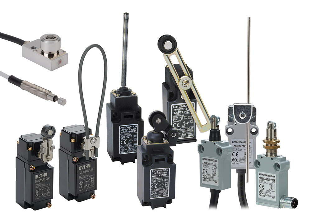

Figure 1: These limit switches are available in a variety of shapes and sizes to fit a wide range of applications.

Industrial limit switches are the battleships of the sensor world and have been used in manual, semi-automatic and automated machinery applications for more than 100 years to detect presence and position of parts and mechanisms. These sensors come in several configurations including NEMA, heavy-duty IEC, double-insulated IEC, compact, miniature and precision, Figure 1.
The major difference between NEMA and IEC limit switch is the robustness, a common distinguisher in these comparisons. The NEMA is designed for demanding applications such as in heavy machinery, foundries and mining, and tends to be more expensive. In applications such as material handling and gantry equipment, a similar but more cost-effective heavy-duty IEC limit switch is usually suitable. Both the NEMA and heavy-duty IEC housings are typically made of metal, die-cast zinc alloy or aluminum depending on the device.
Double-insulated IEC limit switches are typically made of plastic, and the compact IEC switches are made of plastic or metal. Many of the precision touch limit switches are made of stainless steel. Precision limit switches have a barrel design, similar to a very small (M5 x 0.5) proximity switch. These stainless steel, plunger actuation switches have a high degree of repeatable accuracy.
