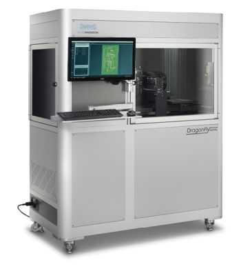

DragonFly
Nano Dimension’s 3D printer handles sophisticated PCB designs with its ability to do 3.5-mil trace widths and a similar pitch. The Dragonfly also has a big print bed, 20×20 cm., or almost eight inches on a side.
A machine from Nano Dimension aims at more sophisticated PCB designs with its ability to do 3.5-mil trace widths and a similar pitch. The Dragonfly also has a big print bed, 20×20 cm., or almost eight inches on a side.

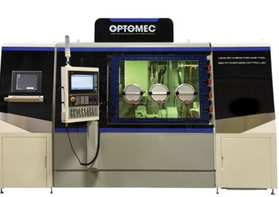

Another high-end additive machine comes from Optomec. Its print heads are offered in the form of print engine assemblies. The assemblies can be built into conventional automation equipment such as CNC positioners or special-purpose motion control systems. Several print engines can be combined to print simultaneously as for mass production settings.
Optomec
Optomec print heads, called Aerosol Jets, create a tightly focused beam of ink by first atomizing the ink supply into a mist, then surrounding it with inert gas. This sheath gas speeds up the flow of the atomized ink as it traverses between the head and the substrate and behaves as a focusing mechanism. These print nozzles deliver ten-micron-diameter collimated streams of atomized ink.
The Optomec print heads differ from those used for conventional ink jetting. Ordinary ink jets depend on gravity to bring ink drops to a substrate. The drops spread out or widen as they fly from the nozzle to the substrate. In contrast, Optomec print heads, called Aerosol Jets, create a more tightly focused beam of ink by first atomizing the ink supply into a mist, then surrounding it with inert gas. This so-called sheath gas both speeds up the flow of the atomized ink as it traverses between the head and the substrate and behaves as a focusing mechanism. The result: From print nozzles having 100-micron diameters come ten-micron-diameter collimated streams of atomized ink. The print engines can create features as small as 10 microns wide and make deposits with thicknesses measured in nanometers. Conversely, the same print head can make features that are several millimeters wide and several microns thick. And features at both extremes can be printed in the same pass.
