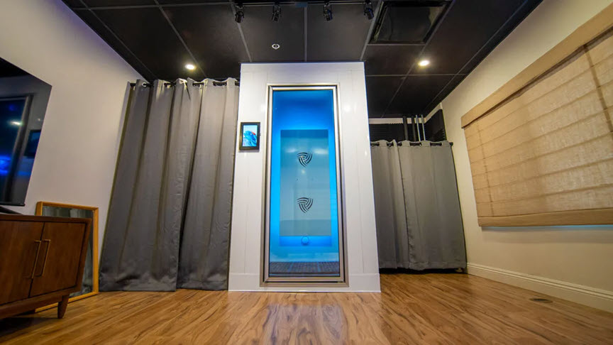

To address these issues, CryoPhit USA of Spring Valley, CA manufactures cryotherapy chambers using electric cooling systems, which may simplify maintenance and reduce some of the operational concerns associated with LN2. However, these electric systems present their own technical challenges.
A CryoPhit USA cryotherapy chamber features an electric cooling system.

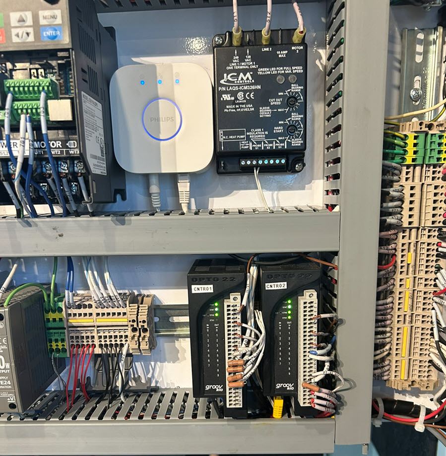

CryoPhit USA needed a solution that balanced cost-efficiency, reliability, and ease of use. After reviewing their system requirements, they selected groov RIO from Opto 22. ​groov RIO is an industrial edge I/O module, designed for IIoT applications. It offers universal, software-configurable I/O channels and supports protocols like MQTT and OPC UA, enabling seamless data collection and integration without the need for a PLC or PC.​
Two groov RIOs handle I/O for each cryotherapy chamber.
The team determined that two groov RIO units could manage all control and monitoring needs, including:
  • 8 thermocouples to monitor internal and environmental temperatures
  • 5 pressure transducers to track refrigeration system performance
  • 2 relay outputs for controlling freeze and defrost modes
  • 1 analog output to adjust the speed of a fan used to maintain a temperature of -80°C
Each device cost less than $1,000, allowing CryoPhit USA to implement the entire control system within a modest budget.
