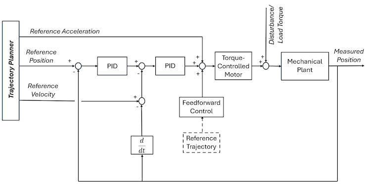

Trajectory control
In trajectory control, the reference trajectory—defined in terms of position, velocity, and acceleration over time—is provided to the control system. The system then uses feedback control laws to ensure that actual outputs, such as position and velocity, closely follow the reference trajectory with minimal tracking error. This is typically achieved using a cascade or nested-loop control structure [3], where PID controllers are commonly employed for both the inner and the outer position loop.
Trajectory control based on cascade nested-loop topology with inner velocity PID control loop and outer position PID control loop.
