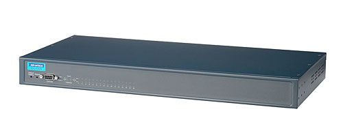

‚– The Industrial Automation Group of Advantech announces the addition of two new 1U rackmount models to its line of Serial Device Servers. The EKI-1528 and EKI-1526 feature 8 and 16 RS-232/422/485 serial ports in a 1U rackmount chassis, which are ideal for high-density remote monitoring, management and control of serial devices over Ethernet and Internet Protocol (IP) networks.
