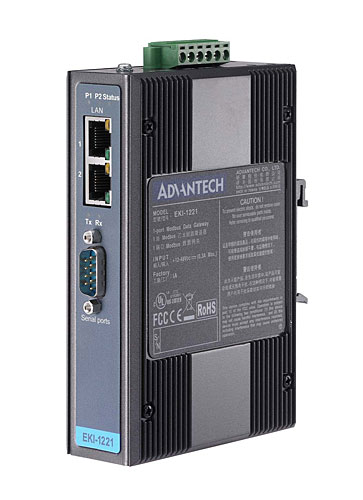

Cincinnati, Ohio ‚– The Industrial Automation Group of Advantech introduces the EKI-1220 series Modbus Gateways, for quick and easy integration of Modbus serial devices with Industrial Ethernet networks. Available in two configurations, the EKI-1221 and EKI-1222 feature one or two RS-232/422/485 serial ports, with redundant 10/100 Mbps Ethernet connections, for transparently connecting Modbus ASCII/RTU and Modbus/TCP devices and equipment.
Transparent Operation
The EKI-1220 series gateways support a wide range of configurations between serial and Ethernet devices, including: Ethernet master to serial slave, serial slave to Ethernet master, and concurrent operation of both modes. More importantly, they are designed for transparent operation, which means no changes are required to installed devices, equipment or software systems.
Advanced Functionality and Security
To route requests to the appropriate serial port on multi-port models, a user-defined table associates Ethernet host IP addresses to serial slave IDs, allowing access through a single IP port, for easier systems integration and compatibility with existing Modbus/TCP networks. A connection status monitor is included, that displays which IP hosts are connected to each serial port, that is very helpful during setup and commissioning or to troubleshooting communications issues. For enhanced security, access can be restricted to specific IP network hosts.
Redundant Ethernet for High Availability
Given the zero unplanned downtime requirements for industrial applications, these Modbus gateways feature dual 10/100 Mbps Ethernet connections, to ensure communications in the event of a network problem. With one physical connection assigned as primary and the other as backup, communications can continue on the backup in the event of a problem with the primary, ensuring uninterrupted communications and peace-of-mind for plant maintenance and operations staff.
Ruggedized for Demanding Industrial Applications
Like the other EKI series Industrial Ethernet products, the EKI-1221 and EKI-1222 are packaged in a compact and thin metal DIN-rail mount chassis. Ruggedized for demanding industrial applications, these units include dual 12 to 48 VDC power inputs, power line surge (EFT) protection of 3,000 VDC, and 4,000 VDC Ethernet ESD protection to ensure maximum system uptime and uninterrupted communications.
