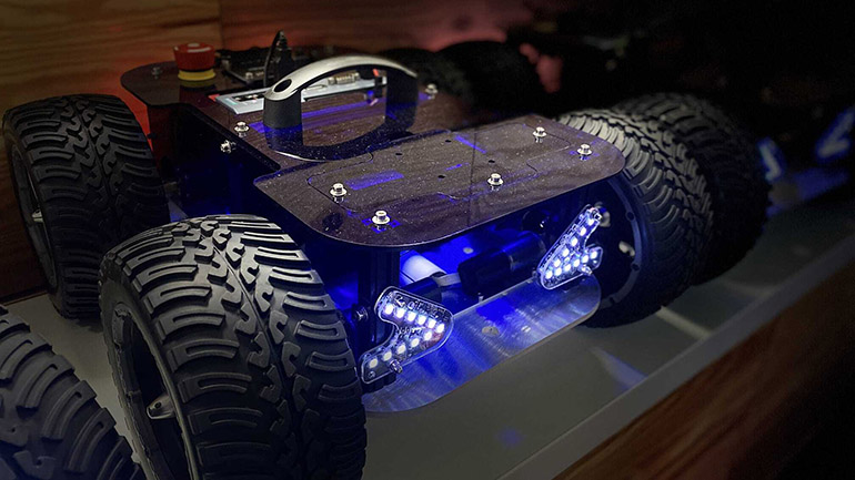

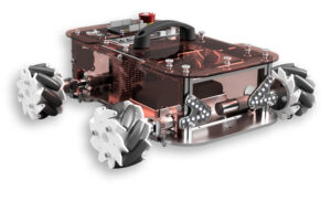

Markus Fenn: The robot itself is called Eduard, he’s about 40 x 40 x 15 cm in size and weighs almost 8 kg. He is the result of a company making an inquiry with Prof. Stefan May. The company needed a platform to educate and train its employees on mobile robotics. That is why EduArt Robotik GmbH also comes with a range of teaching and service offerings for testing and optimization, in addition to the robot platform.
The platform offers simple rubber tires as well as mecanum wheels. These allow the robot to turn on the spot, and drive sideways or diagonally. This enables exact positioning and navigation in very tight spaces. The rubber tires are mainly used for testing in outdoor areas or in rescue robotics, but only in pretend scenarios. The use of high-quality FAULHABER motors is ideal for both applications.

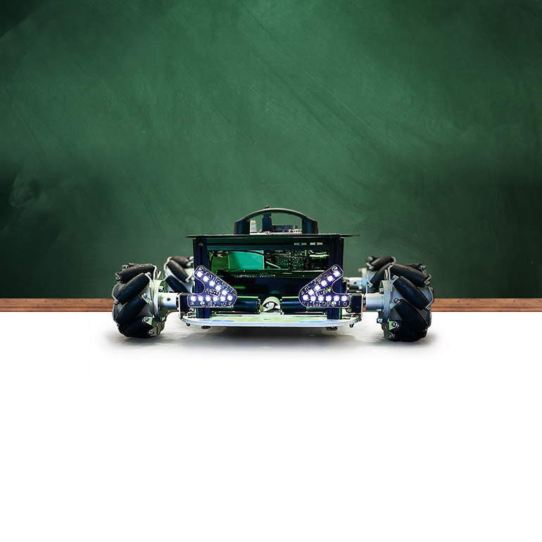

Markus Fenn: The platform has open interfaces, an integrated sensor concept with integrated distance and inertial measuring devices, and an integrated battery management system (BMS). This basic equipment can be expanded at the customer’s request, either by us or the customer himself. This allows the customer to, for example, select the gear ratio of the drive, whether 72:1 or 89:1, depending on the speed or torque required. This enables the customer to cost-efficiently test his new concepts. But we are also helping with the implementation of application solutions.
