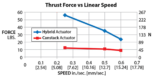

Don’t confuse hybrid stepper motor linear actuators with can stack stepper motor linear actuators. The force vs. speed characteristics, efficiencies, and cost differences between actuators that incorporate hybrid stepper motors and those that use can stack stepper motors can be substantial, although each technology has unique strengths and best-fit applications.
thrust-force-vs-linear-speed
Stepper motor linear actuators can be driven by hybrid motors or by can stack motors. While their performance characteristics are different, each one has best-fit applications.
Image credit: Haydon Kerk

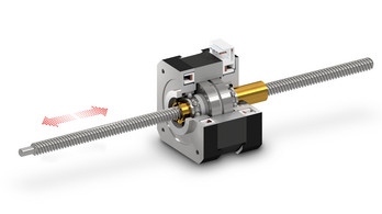

  • Non-captive: In this type type of actuator, the ball or lead screw nut is integrated into the motor (or mounted to the face of the motor) and doesn’t travel along the screw. Instead, the screw must be prevented from rotating (typically by the attached load), and when the motor and nut turn, the screw travels linearly, back-and-forth “through” the motor-nut combination. Alternatively, if the screw is fixed so that it doesn’t travel, the assembly essentially becomes a driven nut design, where the motor’s rotation causes the motor-nut assembly to travel back-and-forth along the stationary screw.
    hybrid stepper motor linear actuator non-captive
    Image credit: Nanotec

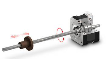

  • External: These actuators use a motor with a hollow shaft and integrate one end of the screw directly into the motor, so the nut remains external to the motor. Like a traditional screw-motor setup, the motor’s rotation causes the screw to turn, which advances the nut (and the load) along the length of the screw shaft. In this design, the opposite end of the screw (not attached to the motor) is unsupported, which is acceptable for light loads and short stroke lengths. However, many applications will require support for the free end of the screw, along with a linear guide to support any radial loads.
    hybrid stepper motor linear actuator external
