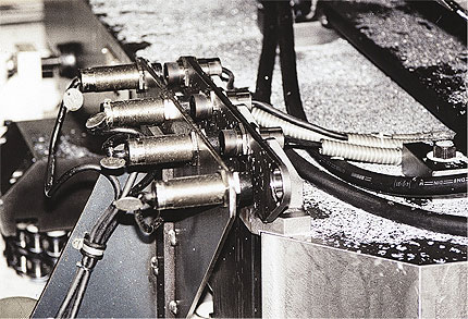

Workpiece position sensing in a machining center at MTU Friedrichshafen uses remote inductive couplers. Up to 16 sensors detect the positions and recognize the part to be machined based on certain features. After loading, the pallet is brought into the machining area.
A key engineering challenge was to minimize tool changeover time. The shoebox tools have up to 16 sensors and pneumatic clamps that require rapid and continuous changes. The engineers initially looked at using Profibus to communicate between the tool and sensors, but the availability time after a tool change was too long.< Balluff Inc. (Florence, KY) recommended using a new connection technology called IO-Link. As a transparent extension of the Profibus network, IO-Link allows reliable connection through standard cabling to small machine-mount I/O blocks located directly on the shoebox tooling.
The remote inductive coupler can be used in applications that traditionally required wiring, such as end of arm tooling or on rotating machinery.
With that challenge solved, the next was maintaining reliability with the traditional mechanical pin-based connection systems even under the high volume of tool changes. Balluff developed a solid-state, non-contact connection device that communicated through IO-Link.
Operating off the inductive coupling principle, the remote inductive coupler passes power and data for the sensors through an air gap down to the shoebox tool. It can send signals bidirectionally, so the coupler can send an output as well as receive an input from a PLC. The Comau tool is passing serial signals, so this unit was passing 16 I/0 points plus diagnostics.
Because power and data are sent though an air gap, flex cables, slip rings, and other wired approaches are not needed.
