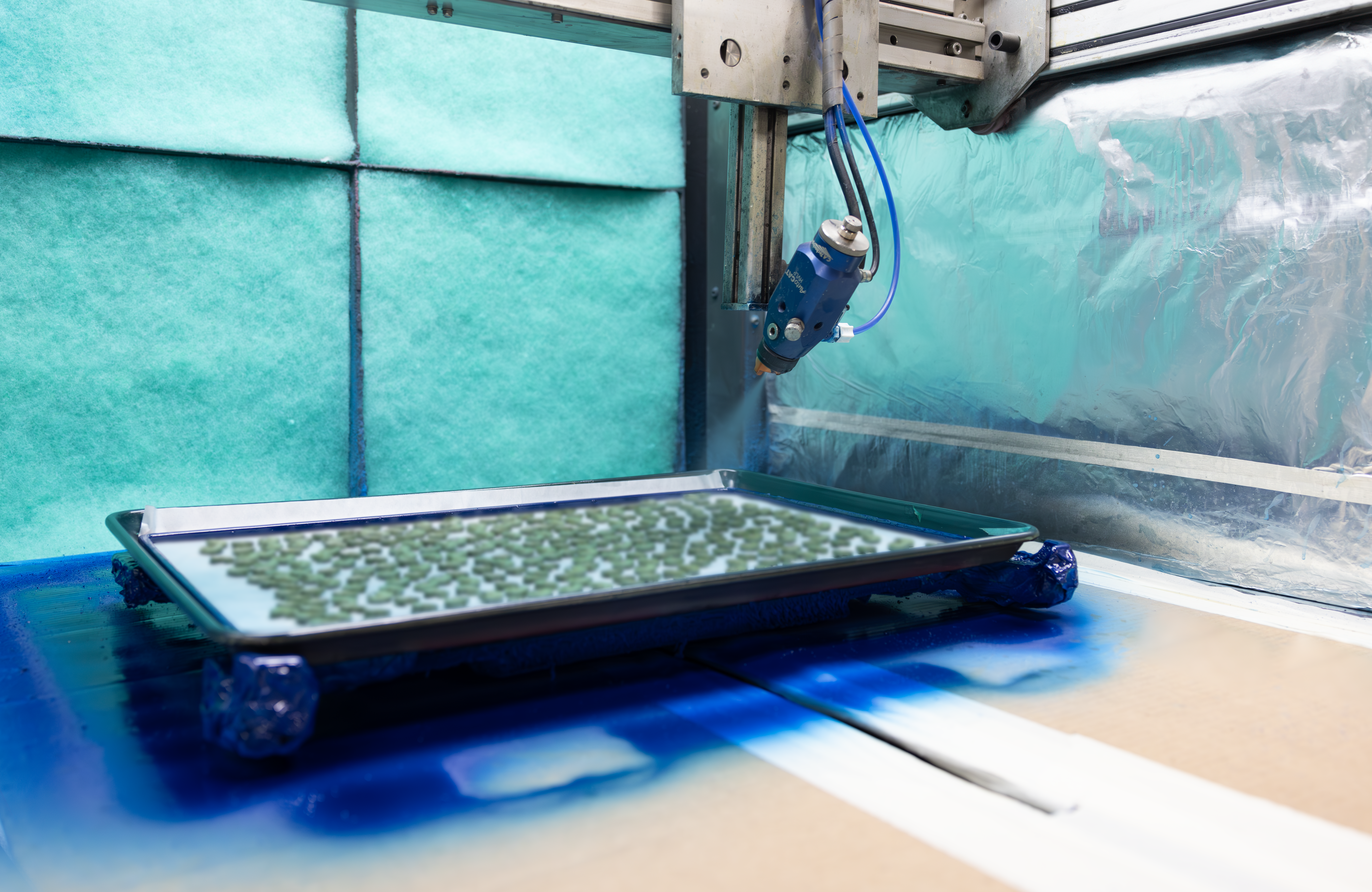

X-Y tables are used in the application of coatings on simple parts. Image: Orion Industries Ltd.

When robotics came on the scene in the late 1980s, they were mostly X-Y coating tables for coating straightforward round or flat parts. Such Cartesian machinery carried a spray gun back and forth over parts to coat them — eliminating the risk of a human operator becoming fatigued from holding a spray gun attached to a pressure pot or a cup gun for several hours at a time. Such X-Y coating tables also reduced the effect of human error on finished workpieces. Finally, such machinery could be programmed to shut off in between parts, preventing valuable material from being sprayed into the air and wasted. Still, applicators lamented that X-Y tables only achieved 60% to 65% coating-application efficiency, only modestly better than that of hand spraying. Incremental improvements only took X-Y table efficiencies to 70% or so.
