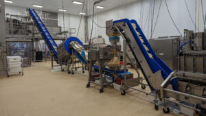

Figure 1: Pacific Cheese operates a variety of automated equipment to convert and package cheese in many different sizes and styles for major retailers and food service customers. Maximum uptime and flexibility are key to success.

Pacific Cheese converts and packages cheese for major retailers and food service customers. Most of the products are blocks and pouches of various sizes, each with specific demands for processing and labeling. Retail products might range in size from eight ounces to two pounds, while food service options could be five or even ten pounds. Various equipment is necessary to perform this work (Figure 1).

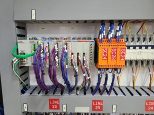

Figure 2: By standardizing on AutomationDirect Productivity1000 PLCs, Pacific Cheese Company has performed many automation retrofits and upgrades while minimizing the number of parts they need to specify and stock.

Pacific Cheese has generally standardized on the Productivity1000 stackable micro PLC, which provides all of the control, data storage, I/O, and communications capabilities they need in a compact form factor, which retrofitted easily into available cabinets (Figure 2).

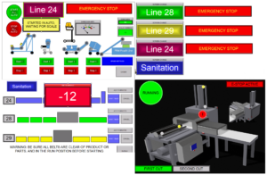

Figure 3: The new automation system makes extensive use of an AutomationDirect C-more HMI so operators can visualize the equipment status, receive warning indications, and perform necessary automatic, manual, and sanitation functions.

Normally, the lines run completely in automatic. However, if a line is stopped, operators can now manually command equipment using the HMI to stage a line for operation (Figure 3). There are clear HMI messages such as “Waiting for Scale” and “Scale Override.”The amps consumed by the shredder are displayed so operators can monitor and fine-tune operation, and some equipment uses the amp readings so the PLC can feed the proper amount of ingredients in a controlled manner.
A new sanitation mode runs the line slowly for 90 minutes with an extendable countdown timer, giving the crew good access to the equipment for proper cleaning and keeping them on schedule. Also, they don’t need to remember to stop the equipment, saving energy.
