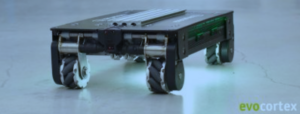

The autonomous mobile robots (AMR) from Evocortex require absolutely no preinstalled guidance system to determine their location and find the right way. They orient themselves simply using the irregularities in the hall floor. Such irregularities can be found even on typical smooth concrete floors and are registered by the robot’s high-resolution camera. The camera is located on the underside of the vehicle, captures an area of 10 x 10 centimeters, and uses the image data to produce the equivalent of a fingerprint of the hall floor.

A normal wheel moves in only the same direction as its axis. To precisely position a vehicle with such wheels, one must maneuver in the same way as when parking a car. To avoid this, the developers at Evocortex opted for the Mecanum wheel. Instead of a closed running surface, barrel-shaped rollers are mounted on its rim. They are fastened at an angle of 45 degrees to the axle of the wheel and can turn about their own angled bearing axis. The shape, size, and spacing of the rollers are selected to give the wheel a continuous rolling surface.
When the Mecanum wheel turns, two force components arise: in the direction of rotation of the entire wheel as well as at a right angle to the wheel’s direction of rotation. Thus, the resulting direction of the movement lies in between: the Mecanum wheel “wants” to move at an angle of 45° to the axial direction. Due to the mobility of the rollers, however, it has no directional stability. If there are additional forces, its own direction of movement can be deflected in any direction.
On a vehicle with four Mecanum wheels, each of the 45° angles are arranged with a 90° offset. Thus, each wheel tries to move in a different direction. By varying the direction of rotation and speed of the individual wheels, the vehicle can be steered in any direction from a standstill or rotated on the spot. On the horizontal plane, it can thus move as freely as a hovercar. The Mecanum wheels thereby enable agile and omnidirectional movement of the robot.

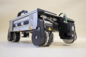

The AMR from Evocortex offer yet another dimension of flexibility: they enable a practically unlimited selection of sizes. “If desired, we can adapt our robot to our customers’ requirements in millimeter increments,” emphasizes Hubert Bauer. “Every external dimension between 400 by 480 and 800 by 1200 millimeters can be realized.” With the EvoRobot R&D and EvoRobot Industrial product lines, these also correspond approximately to the external dimensions of the load-bearing platform. All technology – sensor, controller, lifting unit, and wheel drives – are housed beneath the platform.
The wheel drive module is a decisive element for this scalability. It is located directly above the wheel and, together with the wheel, forms a standardized, independent function unit. As a result, the wheels can be mounted at any distance from one another. The decisive prerequisite for this arrangement is a powerful motor with very small dimensions.

The wheel modules of the EvoRobot are equipped with DC-motors of the 3257… CR or 3272…CR series. Each is fitted with an IEF3 encoder and a 38/2 S gearhead. For fast stopping and to ensure the wheels remain locked in position once stopped, the wheel motors are also equipped with a brake. “Thanks to the enormous power of these micromotors, the EvoRobot can transport up to 200 kilograms. Larger loads will be possible soon,” explains Hubert Bauer. “The transport also functions on a ramp with a slope of up to five degrees and a speed of one meter per second.”
The EvoCarrier product line is designed for transporting small load carriers. In the inner workings of this AMR, things are even tighter than with the EvoRobot. Its ground clearance is less than 100 mm. As a result, it can move into extremely low openings below a transported good. Two or four EvoCarriers can also work together to transport pallets or an entire shelving unit. The developers selected a so-called “flat rotor motor” as the drive here – a brushless motor of the 4221… BXT series measuring just 21 millimeters in length. This allows the EvoCarrier to transport floor rollers loaded with small load carriers (KLTs) weighing up to 120 kilograms in total. In the long term, the managing director believes there will be a transition to brushless motors with the EvoRobot as well and the modules will be further standardized.
