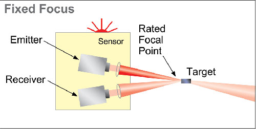

At first, some manufacturers made diffuse sensors with a fixed focal point by rotating the emitter and receiver within the sensor housing. However, a major drawback was found in the mounting position that often did not let the sensor capture the target in its focal-point area.

The development of background-suppression technology came out of efforts in trying to solve the problem of using traditional diffuse photoelectric sensors when shiny surfaces in the background caused false triggers. In first attempts, many sensor manufacturers turned to producing diffuse sensors with a fixed focal point by rotating the emitter and receiver within the sensor housing. A major drawback of these so-called “fixed-focus” sensors is that they cannot guarantee to capture every target in their focal-point area. This makes sensor mounting difficult, or it could require a unique sensor for a particular range.

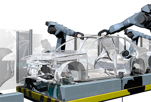

Long-range, background-suppression sensors are the best choice for detecting large objects or for applications where mounting restrictions require that the sensors be located a specific distance from the manufacturing process. Here are two examples:

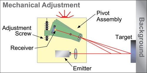

Another sensor type is mechanically adjustable. This type of background suppression sensor contains a potentiometer mechanically linked to the receiver assembly. The potentiometer adjustment changes the angle of the receiver with respect to its lens and the set point at which the reflected light from the target turns on the sensors’ output.

Long-range, background-suppression sensors verify the position of a car assembly. This speeds the assembly process and improves the quality of the final product.
