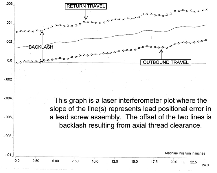

Backlash and stiffness are two important properties associated with motion control systems. Backlash is a characteristic of a mechanical drive system; clearances among the elements create slop when stationary, and dead play during reversals. Stiffness, on the other hand, is a property of a mechanism or a component and is simply the resistance to deformation or deflection when under a load.

The big difference between errors caused by backlash and stiffness is that backlash is independent of the load and is usually detected with light loading. Motion resulting from lack of stiffness (or compliance) is proportional to loading. If movement versus loading is plotted, backlash is characterized by measurable movement at constant, very low loading. Usually, system drag and inertia create enough resistance to reveal any backlash when the direction of motion is reversed. However, compliance is characterized by increasing movement with increasing loading. Depending on the stiffness, a significant amount of force may need to be applied in order to detect compliance.
If there is any backlash in the system, then when the load is removed, the system will not return to the original starting position on its own. Usually, it will need a restoring force to return to the original position. If any compliance is in a component, on the other hand, the system will usually recover on its own once the load is removed. Depending on the materials, compliance could cause a delayed or incomplete recovery (hysteresis) or permanent (plastic) deformation.

The calculations show how backlash is related to the axial clearance in a leadscrew.
