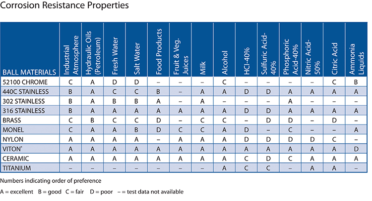

Here’s a look at the corrosion resistance properties of various ball bearing materials.
