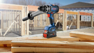

Bosch Power Tools, the global provider of power tools and power tool accessories, has introduced its strongest new hammer drill/driver and drill/driver under the PROFACTOR System to date — the GSB18V-1330C and GSR18V-1330C.
Featuring BITURBO Brushless Technology, the newly engineered tools from Bosch Power Tools provide users with high power and precision at every job.
These newly designed models provide users with high power, kickback control, and leveling-angle control to accomplish a range of heavy-duty tasks. Additionally, the hammer drill/driver and drill/driver include Bosch Power Tools’ BITURBO Brushless technology to help energize the next generation of high-powered cordless tools.
“When it comes to making the job more efficient, our team at Bosch Power Tools understands that users need a high-powered hammer drill/driver and standalone drill/driver to get the job done right the first time for heavy-duty applications,” said Will Shiel, product manager for Bosch Power Tools. We are excited to add these two new tools to our premium PROFACTOR System that are our strongest hammer drill/driver and drill/driver versions to date.”
Features
The cordless GSR18V-1330C drill/driver and GSB18V-1330C and hammer drill/driver deliver high torque with user control in each application, supporting pros with the power they expect to have on-hand when working on a variety of job sites.
- Kickback control: Helps reduce risk of injury on the job from sudden rotational torque reaction in a bind-up scenario, keeping users safe.
- Electronic-angle detection: Allows for driving fasteners at a precise angle. An LED light at the top of the tool shows green when the tool reaches the set angle.
- Two-speed metal gearbox: Users can choose between high-torque (0-550 rpm) driving or high-speed (0-2,200 rpm) drilling to meet their real-time needs.
- Drill-Area LED with feedback: This feature helps illuminate dark zones while in use.
- Upgraded all-metal chuck: The chuck was designed with durability and first-rate bit retention in mind to stand strong during intense hammering and drilling tasks.
- Connectivity: Link to any connected device via Bosch Toolbox App to customize tool settings and receive feedback.
“These new models deliver 1,330-inch-lbs. of max torque, Kickback control on/off via the onboard user interface, and a clutch with 25 settings providing driving accuracy for reduced fastener damage,” explained Shiel. “They also feature electronic-angle detection to ensure accurate drilling at a desired angle. The tools offer preset angles on the User Interface and custom angles in the Bosch Toolbox app. With these enhancements, the GSR18V-1330C and GSB18V-1330C are an asset to every pro’s tool bag.”
