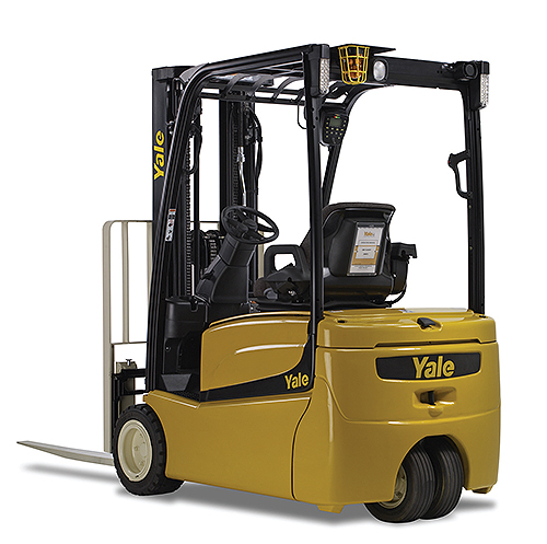

Engineers at Yale Lift Trucks recently redesigned its existing PK-35 braking system for its next-generation three-wheel truck series. They had to make the new trucks smaller and add a parking brake with a manual release.
Several different Yale and Hyster brake sit-down counterbalance trucks use the new PK-35 brake.

The newly modified PK-35 brake is an integral component on several different series of Yale and Hyster brand 3,000 to 4,000-lb capacity sit-down counterbalance trucks. It is also being installed on a series of three-wheel stand trucks. All platforms use independent in-line drive unit motors for maneuverability and are variations of 36V and 48V trucks. The new brakes incorporate a manual override that allows the truck to be towed with no need for additional tools or power sources.
