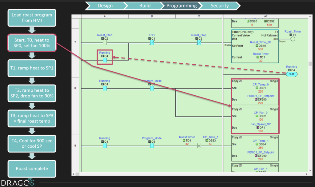

Based on an understanding of the coffee roasting process, how the roaster works, the PLC and HMI capabilities, and the desired user functionality, it was time to develop the program. The PLC would execute five steps, and users would configure setpoints, a start command, and monitor the operation using the HMI.
• Step 1: Start and heat to setpoint 0 (SP0) with the fan at 100% (Figure 3).
• Step 2: Ramp heat to SP1 for drying.
• Step 3: Ramp heat to SP2 and slow fan to 90% for ‘first crack’ (Maillard).
• Step 4: Ramp heat to SP3 for “second crack” (final roast).
• Step 5: Cool for 300 seconds or until a cool SP is reached.

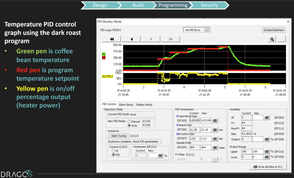

• Whenever heating was needed in any step, PID controls (with time proportioned on/off heater output) would be used to control the temperature at SP (Figure 4). The PLC monitor mode was used to tune the PID loop, and the PLC’s real-time control functionality was then used to monitor the setpoint and actual process variable temperatures as the roasting process proceeded. This information was graphed and displayed on the C-more Micro HMI. For general operation, several local HMI screens were developed to indicate the running status, set the profile mode (and any associated setpoints), and indicate alarms (Figure 5).

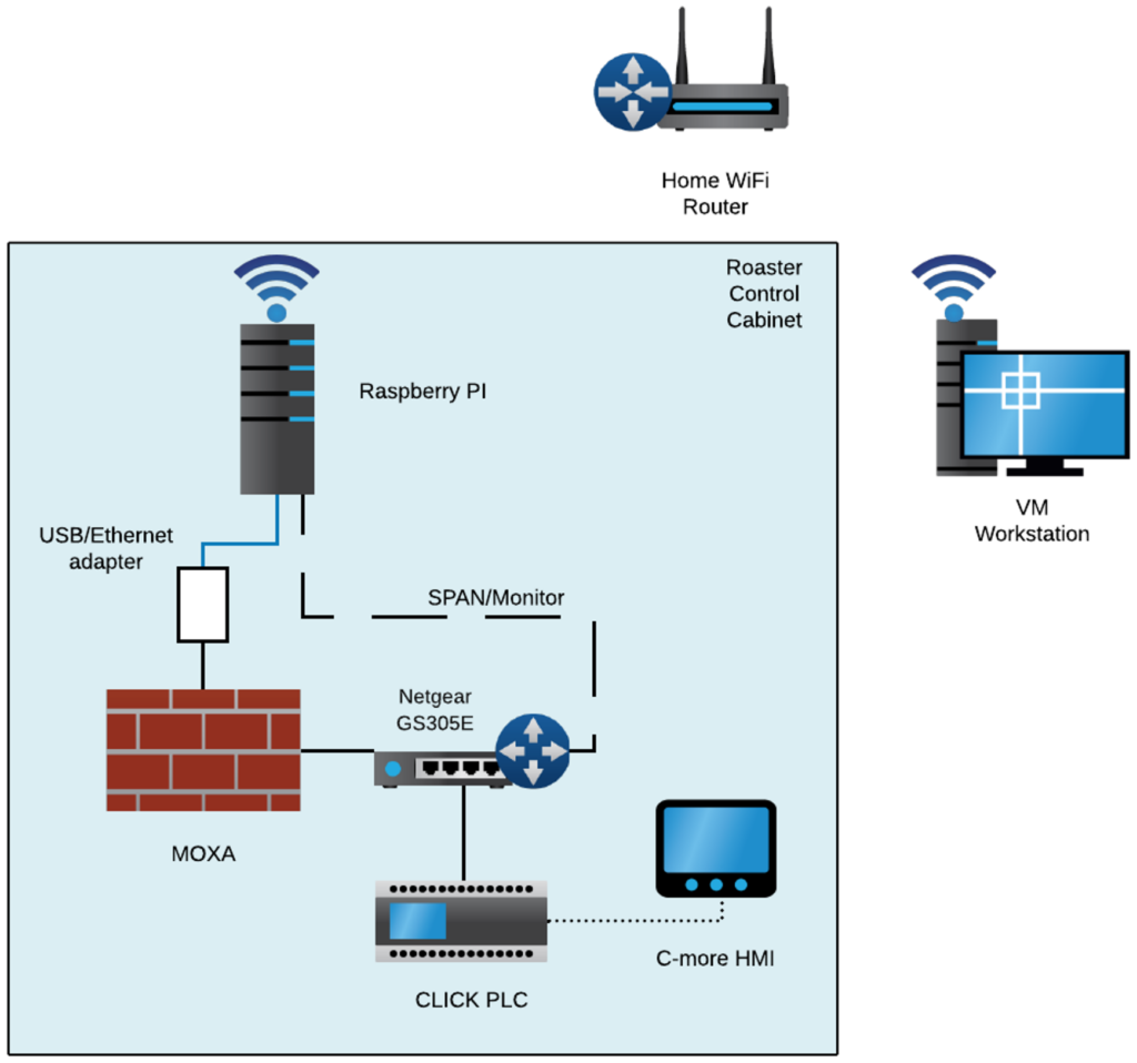

In this case, a Raspberry PI v4 was configured as a router and a wireless network bridge, in conjunction with a Moxa firewall, and connected into an architecture with considerations for security monitoring (Figure 6). The firewall enabled a secure remote connection between the engineering workstation (a Windows 10 VM with the CLICK PLC programming software installed) and the remote PLC. The firewall rules were configured to restrict connectivity between the VM and PLC over the configuration UDP port. Because coffee roasting can produce a fair amount of smoke, the PLC was located in the garage. Therefore, having secure remote connectivity was a significant advantage for colder months.
Fig6_network
Figure 6: This simplified network architecture depicts how a DIY PLC project can be connected to a network for providing convenient yet secure remote access.
The firewall also could restrict Modbus communications to the CLICK PLC down to the protocol function level for data reads and writes, ready to support a future remote HMI. The Raspberry PI was also set up with an additional Ethernet interface to monitor the PLC and external systems’ traffic. This allowed a future project to continuously capture network traffic via tcpdump and send those packet captures to Zeek or the Dragos community tool, Sophia, for network security monitoring.
