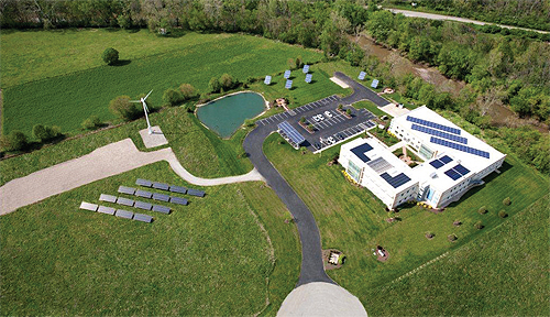

At the recent “Making it Here” renewable energy conference in Cleveland, Steve Melink, CEO, Melink Corp., spoke about his Cincinnati-area company’s green campus. Melink Corp., which is in the business of selling green products to national restaurant, retail, supermarket, and hotel chains, among other businesses, decided to build its own corporate headquarters as green as possible.
The resulting campus has been rated LEED Platinum campus and is net zero energy, according to Steve Melink. He said the campus is a showcase for what they do as a company. And he said he was concerned that the U.S. might be falling behind in what may become a green engineering economy.
“There was the Space Age, the computer age, the internet economy—and the U.S. has led all of those,” Melink said. “Next is the clean energy economy and we are at risk of not being the leader there.”
Let’s look at the numbers. Melink said that the original incremental cost when building was built in 2005 was $250,000. Improvements made from 2006-2009 totaled $250,000 and further improvements added in 2010-2011 were $250,000. Net costs after tax credits and grants were $25/sq-ft for the 30,000 sq-ft complex. The average office energy cost is $250/sq-ft/year, so a similar size bldg is $75,000/year. A simple payback calculation is $750,000/$75,000/year = 10 year payback, and ROI = 10%.
