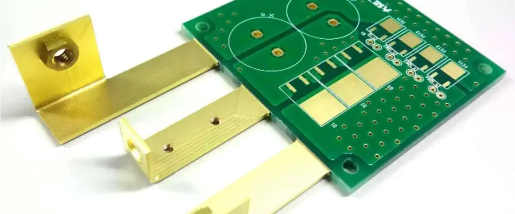

Bus bars are not limited to “freestanding” runs of a meter or more, or hundreds of amps. While many busbars are custom-shaped and sized to fit the unique needs of the application, there are also smaller busbars that are used directly with a PC board, shown in Figure 2; these also act as board stiffeners.
Figure 2.  Smaller busbars are available, which connect directly to the PC board. (Image: Rayming PCB and Assembly)
