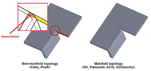

The geometric modeling kernels in different CAD programs can represent topology in different, and incompatible, ways.

The other big part of the problem, according to Stallings, is that different CAD systems represent geometry and topology in radically different ways. He pointed out one of his favorite examples: that in ACIS a cylinder is a cone and in Pro/E a sphere is a torus. Larger differences include such things as how surfaces are parameterized. A more difficult problem is with advanced procedural surfaces such as blends and lofts. There can be many undocumented, cryptic, even unimplemented options in these.

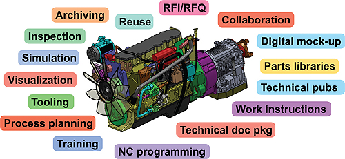

»These are a few of the typical downstream processes, which can make use of 3D CAD data. MRAP CAT I A1 engine model by SURVICE Metrology.
