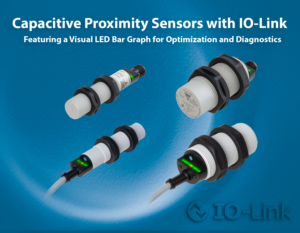

Carlo Gavazzi Automation has introduced two new capacitive sensor series: the CA18CB..IO and CA30CB..IO. These sensors feature an integrated LED bar graph and IO-Link communication capabilities.
The sensors incorporate an LED bar that displays ON/OFF stability status. Green LEDs positioned on either side of the yellow switching LED indicate signal stability and dust accumulation levels. This visual feedback system enables real-time monitoring of dirt and dust buildup, indicating when cleaning is required for continued reliable operation.
