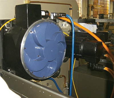

A typical installation plainly shows the
neat arrangement (bottom) of the CDDR and obvious lack of wiring and
components that are needed in the more conventional arrangement.
