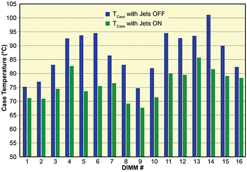

The next step was simulation of an air bullet implementation that would work in the real world. In theory, an actuator of sufficient capacity can drive cooling air pulses through manifolds and out multiple ports. The design team was to confirm this theory and create a dedicated cooling source for a bank of 16 dual in-line memory modules (DIMMs) situated at the rear of a 1U rack server.

Results from CFD simulation “B.” The maximum DRAM case temperature with the jets off is 101.1° C, which exceeds the devices’ rating. With the jets active, the maximum case temperature drops to 81.5° C, a reduction of 19.6° C. The average temperature drop across all DRAMs is 11.2° C.
In simulation “A,” the near end of the circuit board mount contains 12 jets that shoot pulsed air between the fins of a heat sink mounted atop a 15 W IC package. The jet pulses were delivered at a 50 Hz frequency, just like the earlier entrainment experiments, and at a peak velocity of 30 m/s. The simulation was performed with and without the virtual jets. Ultimately, the CFD model showed a maximum temperature rise of 55° C with pulsed jets enabled and 195° C with convection cooling alone. The FloEFD tool’s result compared favorably with a bench-top test that produced a temperature rise of 59° C. The average temperature drop across all DRAMs is 11.2° C.

Simulation “B” depicts the proposed air bullet distribution hardware with manifolds and “slot runners” that direct air to the server’s DIMM array. Each manifold is connected to opposite sides of the jet actuator, resulting in the air pulses being 180° out of phase for alternate DIMM cards. The peak jet velocity at each of these ports averages 70 m/s.
