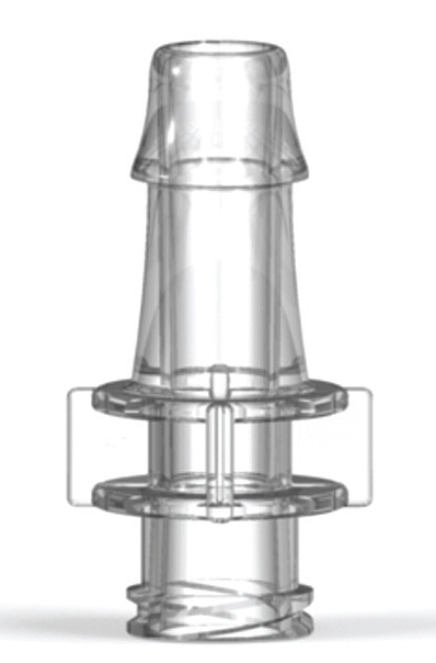

Luer Connectors – delivery systems can use conical or taper seal connectors, called luers, to link various system components. The male and female components of luer connectors join together to create secure, yet detachable, leak-proof connections with no o-ring or gasket required.
plastic-conical-and-taper-seal-connectors
Plastic conical or taper seal connectors, called luers, can link various industrial and laboratory system components.
Luer connectors come in a variety of configurations adapting to tube connections, threaded connections (UNF, NPT and metric) and other luer or quick connect terminations. Some of those incorporate a tapered UNF thread, similar to a pipe thread, which can also seal on the thread due to interference on the pitch diameter, facilitating directional alignment with tees and elbows.

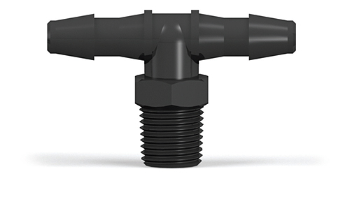

Barbs
Plastic barb-style connectors accommodate the widest possible range of tubing properties and application conditions, including a multitude of configurations such as tees, Ys, elbows and manifolds. A number of barb designs are available – each with unique characteristics to tailor connection performance to specific needs – for handling assembly forces, tensile resistance and blow-off resistance without the need for clamps.
Barbs holding capability is attributed to the expanding tubing above its nominal inside diameter (ID), creating some amount of interference for a secure seal and good mechanical retention. The tube expansion can vary from lower profile and easier connections to a more aggressive interference, depending on the pressure and tensile pull requirements.
The selection of the barb style is important to the connector’s tube holding capability. The cylindrical surface behind the barb should allow the tubing to relax against the connector. In choosing a barb style, it should be designed with a sharp peak, allowing it to “bite” into the tubing for optimal retention.
Many plastic connectors and almost all metal connectors use a multi-barb, making for an inferior tube connection and seal. Multi-barbs cannot create a sharp bite on the tube, which inhibits retention, thus not allowing the tube a chance to relax behind the barb, which results in poor tensile pull strength.
Multi-barbs are also relegated to a manufacturing process that leaves a parting line on the sealing surface, creating a potential leak path. This is an inherent design flaw, yet all multi-barb connector designs, including metal connectors, display this liability. An optimally designed and properly injection molded connector will incorporate a singular barb with no parting line, a sharp bite and a clean sealing surface.
