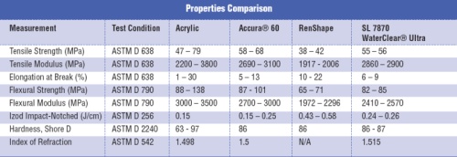

Several translucent ABS like SLA resins are currently available, and several clear
resins were recently added to the engineer’s RP toolbox. Previously, clear resins
usually involved durability tradeoffs. Newer, clear resins no longer have these tradeoffs. Just five years ago translucent materials were rather fragile and could not be used for high impact, high pressure, or high-temperature tests. Newer, much
tougher resins were developed to address this problem.
New translucent and clear SL resins such as Ren-Shape® SL 7870 made by Huntsman, Accura® 60 made by 3D Systems, and WaterShed® XC, as well as WaterClear®Ultra produced by Somos are only a few examples.
Carl Holt, Commercial Sales Manager for NAFTA for Stereolithography of HuntsmanAdvancedMaterials, explains that his company specializes in the formulation of ready-to-use SLA resins and offers approximately 30 SLA resins
for various applications. Huntsman clear materials are high-clarity photopolymers;
they are neither a polycarbonate nor an acrylic.
Huntsman’s RenShape SL7870 is a high clarity resin that also has extremely high
impact strength. Another benefit of this material is that it does not age as rapidly over time as many other earlier clear resins. Huntsman also produces a UV-blocking coating (primer) to protect the clear parts from sun damage.
Clear resin manufacturers typically publish standard sets of ASTM information on their Web sites. Since new materials are constantly added to the portfolios
(although not all service bureaus include them in their line), it is always a good idea to check with the resin manufacturers to find out what new materials became available recently and which service bureaus are capable of processing them.
