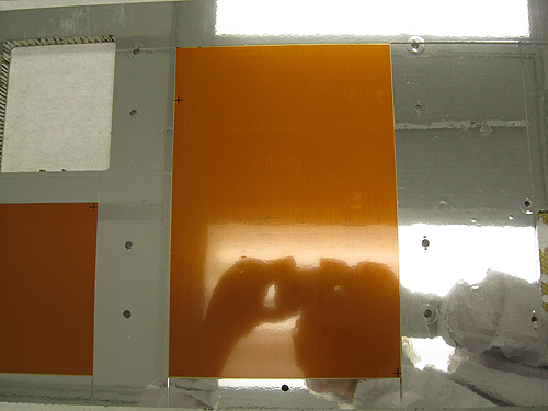

NEOSSat-solar-panel-substrate
NEOSSat solar panel substrate during initial receiving inspection.

The laminate laydown was done on NEOSSat’s solar array components. In addition to strict adherence to precise tolerances of the lamination’s pre-defined size, shape and thickness, the extremely tight constraints of the laminate lay-down and meticulous nature of the job necessitated Boyd to develop a specialized process for the laminate’s application. Because the components would be used under a vacuum in deep space, the laminate had to be applied within a cleanroom environment to eliminate the possibility of micro-contamination or air bubbles being trapped underneath; the presence of air bubbles or contaminants would contribute to delamination in outer space. Additionally, the positioning of the lamination needed to be exact—to the thousandths of an inch—with no overlaps.
“We went to Boyd Coatings because we knew that they had the experience and expertise to handle this type of aerospace project,” said Adam Latour, MSCI’s Lead Mechanical Engineer for the NEOSSat project. “There was no defined process for this task, but we were confident that Boyd could develop one.”

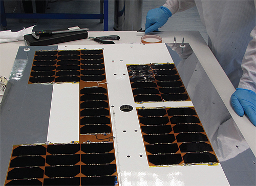

NEOSSat-solar-panel
NEOSSat solar panel during final inspection.
“In many cases, it is the specification or development of a high-performance coating that is the special part of Boyd Coatings’ offering,” said Garcia. “In this case, it was the ability to develop a documented process to lay down the coating in a particularly precise and meticulous manner, ensuring that no micro-contamination or air was trapped underneath.”

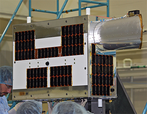

Completed-NEOSSat
The completed NEOSSat underwent Integrated Satellite Testing at The David Florida Laboratory. The David Florida Laboratory is Canada’s world class spacecraft assembly, integration and testing center located in Ottawa, Canada.
On February 25, 2013, NEOSSat was successfully launched into outer space where it now guards Earth, as it was designed to do.
