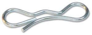

1. Hair-Pin Cotter: Relatively secure, but high-vibration or rotating applications can cause accidental disengagement. Hair-Pins are a spring-type cotter made to be reusable in less critical applications. They provide fast, tool-less installation and removal.

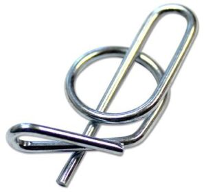

3. Bow-Tie Locking Cotter: Works like a Hair-Pin Cotter, simply push or pull this cotter’s pin leg into the mating hole and the Bow-Tie snaps into a zero-tension locked position. It’s easily released by lifting the loop and sliding the cotter pin off. No tools required. This fastener is also ideal for vibrating and rotating applications, and reduces the risk of being accidentally knocked or vibrated off.
The Bow-Tie Locking Cotter Pin.
