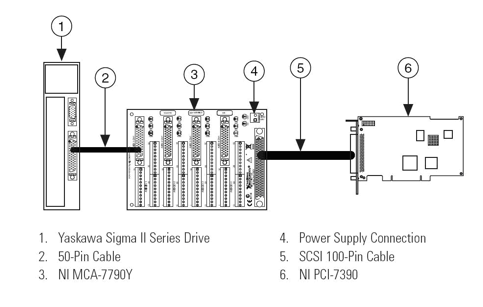

1. Figure 1. Connect the NI PCI-7390 motion controller to the Yaskawa Sigma II amplifier:
The NI MCA-7790Y accessory kit provides connection between the NI PCI-7390 controller and Sigma II series amplifiers from Yaskawa. To connect a Sigma II amplifier to the PCI-7390 controller, connect a 50-pin cable from the amplifier (PN: 194604-02) to the MCA-7790Y accessory kit, and connect a SCSI 100-pin cable from the MCA-7790Y accessory kit to the NI PCI-7390 controller (included with the MCA-7790Y accessory kit). Refer to Figure 1 below.

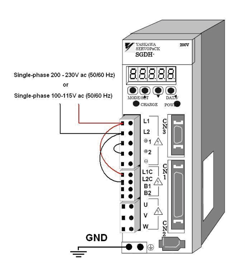

2. Figure 2: NI 7390 Connected to a Yaskawa Sigma II Amplifier i. Provide power to the Sigma II amplifier: For basic applications you can power the Yaskawa Sigma II by connecting the main power pins to an AC power source, refer to Figure 2. For advanced power options, consult the Sigma II User Manual. (www.yaskawa.com) section 3.3.2.
3. Figure 3: Yaskawa Sigma II Basic Power Connections ii. Connect a Servo Motor to the Yaskawa Sigma II amplifier: The Yaskawa Sigma II then needs to be connected to a three phase brushless servo motor via the phase pins U, V, and W as shown in Figure 3 below. For encoder feedback the CN2 connector on the Yaskawa Amplifier can be connected to a motor using the Servo Amplifier Connector Part Number: 53460-0611.
