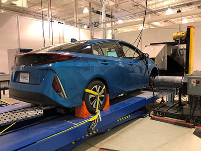

SwRI engineers used internal funding to deploy the eco-driving technology in a mobile driver advisory application, or “app,” that runs on regular smart phones or tablets. The driver advisory app connects with traffic lights and roadway infrastructure to “see” up to half a kilometer ahead and alert drivers to drive more efficiently. For example, if a stoplight is red a few blocks ahead, the app will tell the driver to speed up or slow down by a few miles per hour to avoid stopping. For heavy-duty trucks, making a full stop at a red light and re-engaging the engine when the light turns green is a significant source of fuel consumption.
The team also built a unique connected and automated vehicle (CAV) chassis dynamometer, a system to measure force, torque and power, that interfaces with traffic simulation software to provide a controllable, repeatable environment for testing the new technologies. Calibrated using real-world data from Fort Worth, Texas, the simulator proved critical for evaluating control algorithms and accurately quantifying energy consumption.
