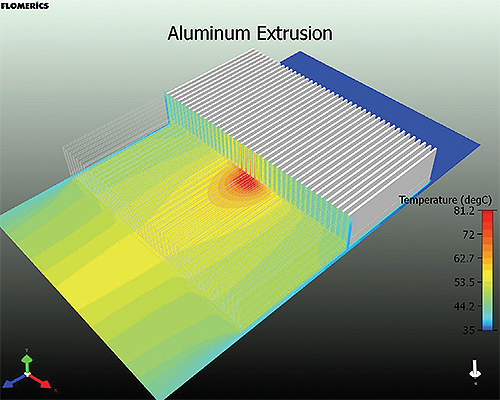

A CFD simulation for an electrical component connected to a 100-W source and its low-profile aluminum heat sink illustrates the high-temperature gradients in a cross-sectional view. The outside fins are cool compared to the hot spot directly over the component.

In order to show this spreading phenomenon, a CFD (computation fluid dynamics) simulation was created for a typical high-flux electrical component and its cooling sink. For this example, a 6-in. by 6-in. by 1-in. low-profile aluminum heat sink with a standard extruded pitch was used to cool an electrical component (0.5-in. by 0.5-in. source at 100 W, or 62 W/cm2). As shown, the high-temperature gradients are evident in the cross-section view. The fins toward the outside edges are quite cool compared to the hot spot directly over the electrical component. The performance of this heat sink with 300 LFM (linear feet per minute) of airflow is 0.46 °C/W, which is the temperature rise from ambient to the hottest spot on the component over the total power dissipated.

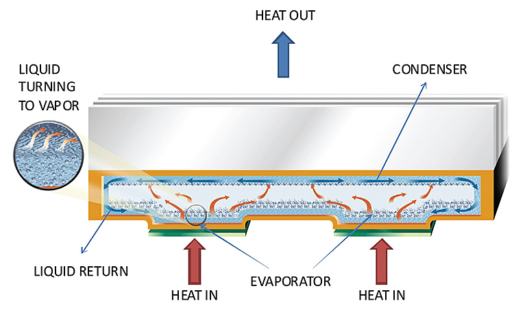

Vapor chambers are essentially flat or planar heat pipes that use the principles of evaporation and condensation to produce a very high conductivity thermal plane. Vapor chambers are basically evacuated vessels with an internal wick and a working fluid. The wick helps transport the working fluid back to the evaporator surface without using moving parts. Once the fluid evaporates, it travels to the cooler section of the chamber, condenses in the wick, and the cycle continues.
Vapor chambers can have a number of different shell materials and working fluid combinations. The selection of these materials depends mainly on the operating temperature of the cooling system. The most common combination in the electronics cooling field is copper and water due to its operating temperature of about 10°C to 250°C, but other liquids and materials can be used for extreme temperature ranges.
Bulk conductivities for vapor chambers have been measured at more than 30 times the conductivity of copper, and more than 10 times the conductivity of pyrolytic graphite and diamond in the same flat plane configuration. In addition, vapor chambers can be bonded into an existing extrusion or used as the base itself, in which case fins can be soldered directly to it. Vapor chamber sizes can range from as small as 1-in. by 1-in. to as large as 13-in. by 20-in. Standard thicknesses range from 3 to 9 mm so they can be easily inserted into existing bases.

To illustrate the thermal performance improvement that a vapor chamber can provide to an all-metallic heat sink, examine the same heat sink that was described earlier, but with a vapor chamber integrated into the heat sink base. As shown, the heat is spread much more evenly across the entire heat sink, causing a drop in overall thermal resistance of 37%. The heat sink shown here with an embedded vapor chamber and all of the parameters held constant exhibits a resistance of only 0.29 °C/watt.
