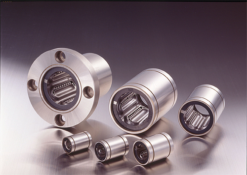

NB-Corporation-steel-side-bush-products
A few of the steel slide bush products in NB Corporation’s SM, KB and SW series.
