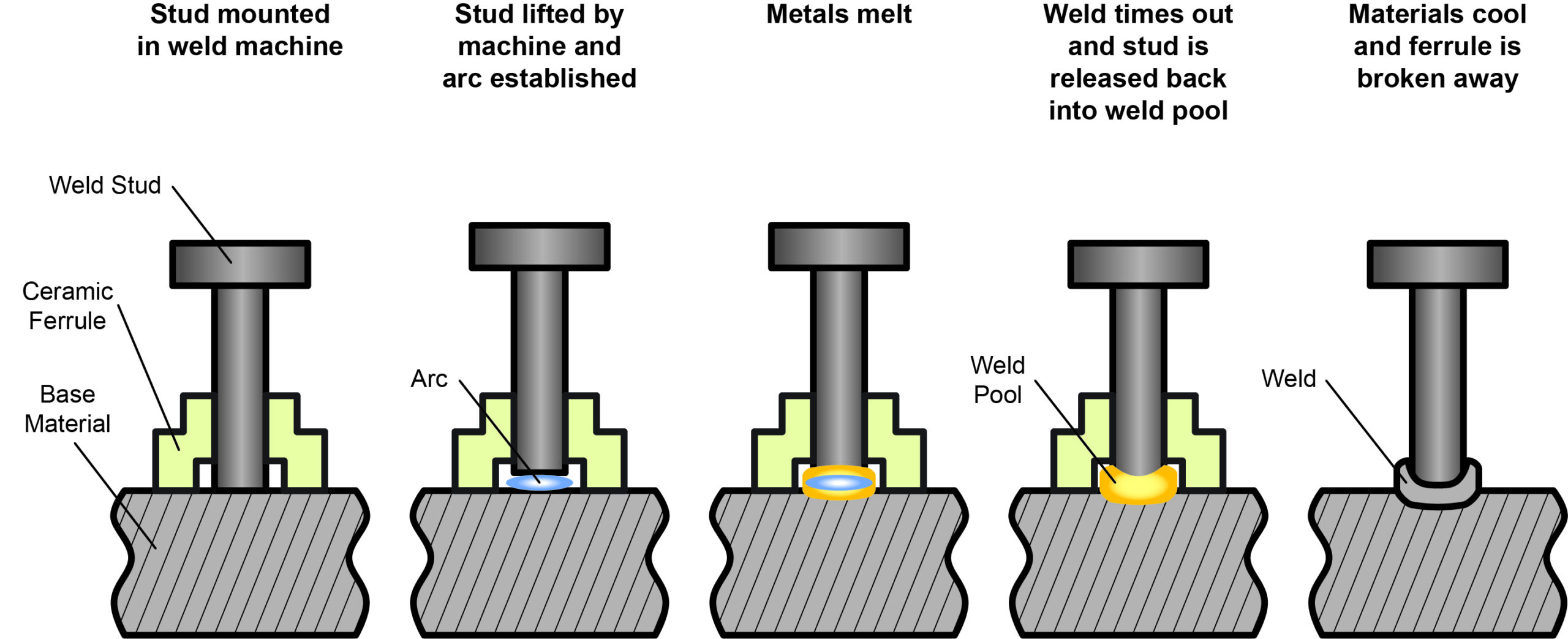

Let’s take the use of DA in bridge construction, as an example. During this process, the fastener is placed against the workpiece and a current is applied. The weld gun then pulls the fastener away from the workpiece, allowing an arc to form. The arc melts the tip of the fastener and the workpiece for a pre-determined length of time. The machine then plunges the fastener back into the molten metal on the workpiece to form the bond.
Typically, the DA process is done in large, open, and uncontrolled spaces, so the fastener will have a flux tip and the use of a ferrule is necessary. The ferrule is a ceramic ring that’s placed around the fastener before welding. This ferrule has teeth on one side that rest against the workpiece and creates a shield around the molten metal. This keeps the molten metal in place and prevents contaminants from getting into the weld pool by holding the flux close to the melt pool.
The teeth also provide space for the expanding heated gasses to escape, preventing an explosion. After the weld is cooled, the ferrules are broken off the fastener and base material joint with a hammer. However, it’s important the ferrule properly fits the location of the installation.
The drawn arc stud welding process. (Image: steelconstruction.info)
