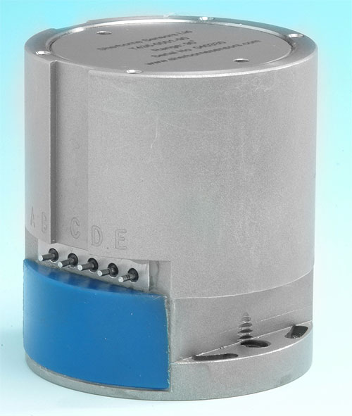

Sherborne Sensors has announced the North American launch of Series T435, a single axis, high-precision, closed loop gravity referenced servo inclinometer family, designed for down-hole logging applications, or for use in areas where space is at a premium.
With a form factor measuring only 1.6 in. (40.6mm) high and less than 1.46 in. (37mm) in diameter, sensors can be stacked for simultaneous X & Y measurement of tilt angles. Models are available in ranges from ±3° to ±90°. Series T435 offer a high-level DC output signal, proportional to the sine of the available angle of tilt. Units are fully self-contained, and able to connect to a DC power source and readout or control device for a complete operating system. The T435 series are also extremely rugged, and can withstand a 1500g shock event. Solder pin terminations are standard.
