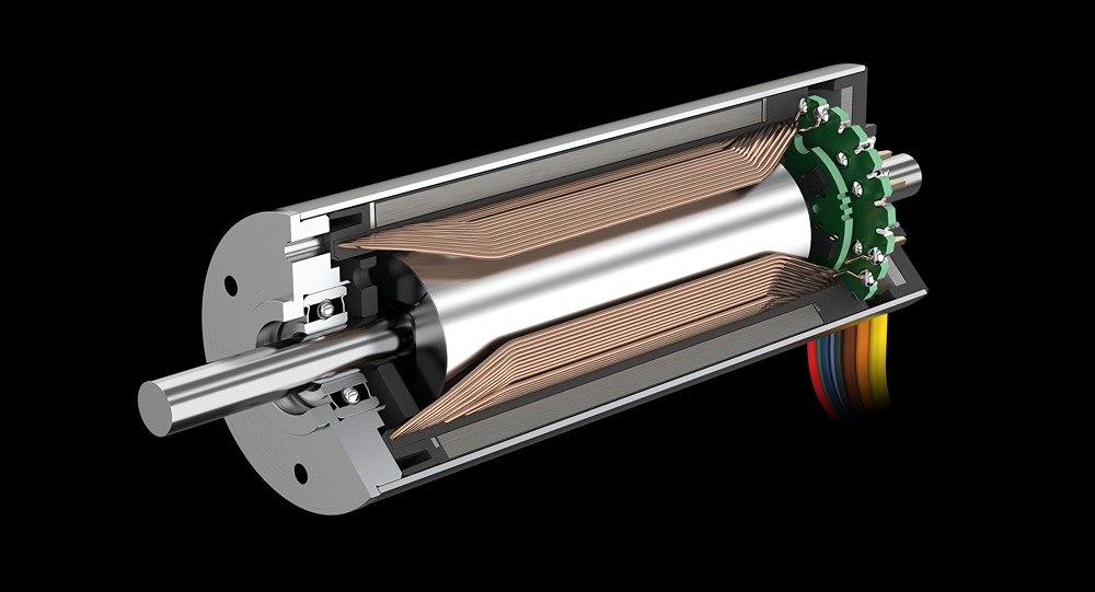

The integrated drive ensures that the control signals are converted into the appropriate movement. At its heart is a brushless motor of the BP4 series from FAULHABER, the power of which is transferred to a lead screw. Motor and lead screw rotate in both directions and thus achieve active dorsal and plantar flexion of the foot. The high energy efficiency of the drive enables an operating time of 12 hours on one battery charge. The motor also tolerates the considerable heat emission that can occur in everyday operation.
“Our objectives were altogether quite sporty,” recalls Marcin Dziemianowicz. “The motor was to be able to emulate a jogging motion – with three steps per second, or three complete cycles of dorsal and plantar flexion. Furthermore, rapid changes in pace and direction were to be possible. For this application, you need very high speed and high torque in the smallest possible volume and with the lowest possible weight. We tried out various drive solutions from leading motor manufacturers. With FAULHABER, we not only found the most suitable product, but also received outstanding technical support.”
