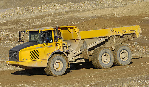

Programming an inclination sensor largely depends on the model and manufacturer. The zero point, or level reference, of the inclinometer may be reset to the unique grade of an application.
Depending on the model, it may be adjustable up to ±15 degrees from the factory setting of absolute horizon level. With this feature you can shift the sensing window to accommodate slightly non-level rest positions of equipment, such as the difference between an empty and loaded dump truck. Some inclination sensors can be programmed through a teaching pendant, which makes configuration a simple, single push-button task.
An inclination sensor may be programmed in a way that shifts the sensing window to accommodate non-level equipment positions, such as the difference between an empty and loaded dump truck.
